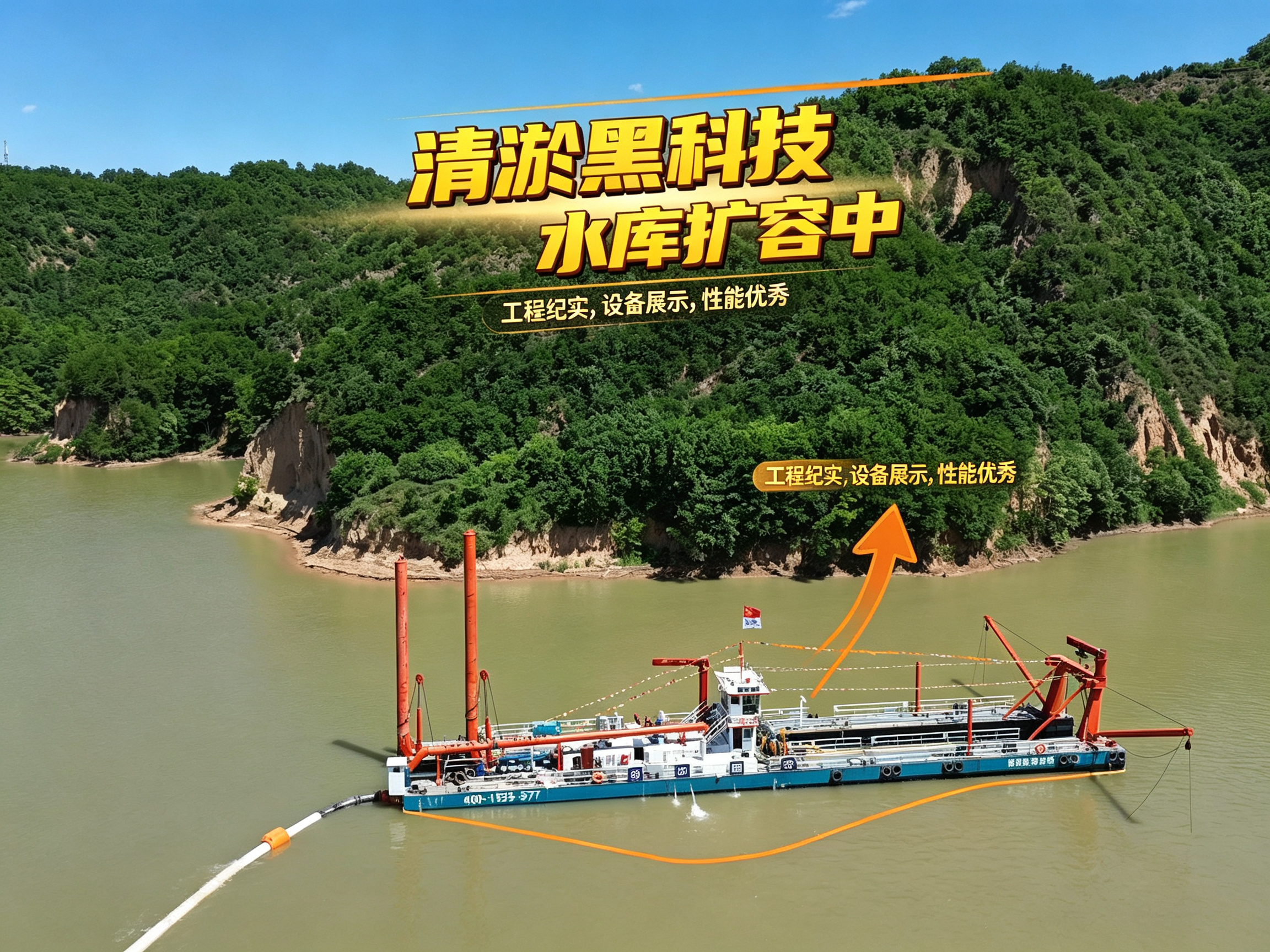

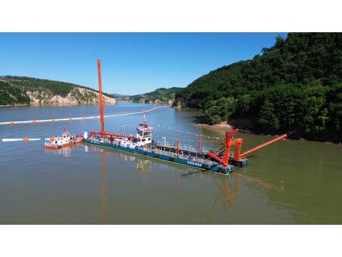

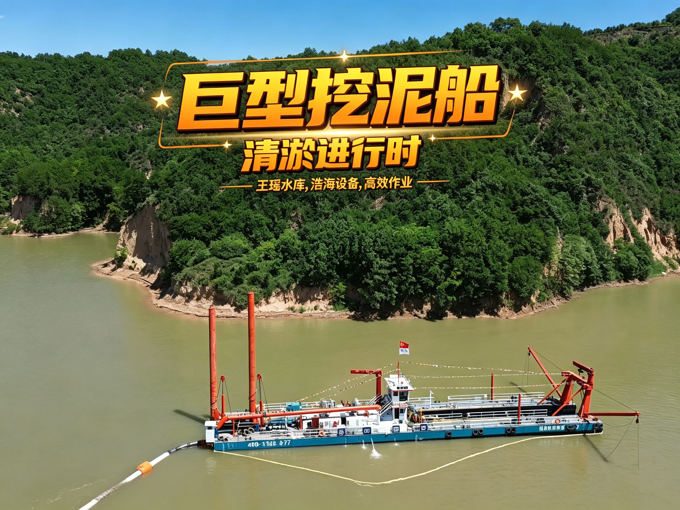

4000方双泵绞吸式挖泥船 设计挖深25米 输送距离可达5000米
山东浩海疏浚装备有限公司.
单价: ¥1500.00 / 艘
浏览: 90
发货: 山东潍坊市 预售,付款后120天内
库存: 100艘 起订1艘 限购100艘
品牌: HID浩海
船长: 63m
型宽: 10.08m
型深: 2.4m
设计吃水: 1.8m
设计挖深: 25m
总装机功率: 3135KW
最大输送距离: 5000m
船型: HID-
船级: 中国 ZC
船旗: 中国
总长: 63.0m米
型宽: 10.08m米
型深: 2.4m米
吃水: 1.8m米
主机: 潍柴动力
主机马力: 1350kw
甲板结构: 装配式模块化
吊机/吊杆: 5T
更新: 2026-06-23 18:42
装配式挖泥船亮点:
1,可拆分模块化设计,运输和转场灵活方便。
2,挖泥船前部铰刀为挖泥船重要挖掘部分,完全自主研发,包含多项专利技术,一项独有技术。
3,为了解决解挖泥泵吸程短的短板,双泵组设计,实现25米大挖深。
4,远排距,水下泵组与舱内泵组配合,具备5000米超强输送能力。
Highlights of Prefabricated Dredgers
  1. Split modular design enables flexible and convenient transportation and site transfer.
  2. The cutter head at the front of the dredger is its core excavation component, fully independently developed with multiple patented technologies and one exclusive proprietary technology.
  3. To address the limitation of short suction lift of the dredge pump, a dual-pump configuration is adopted to achieve a maximum dredging depth of 25 meters.
  4. Long-distance discharge range: the underwater pump set works in tandem with the cabin-mounted pump set, delivering an outstanding conveying capacity of up to 5,000 meters.
